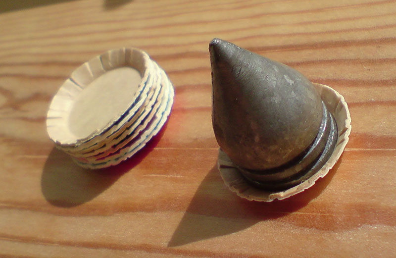

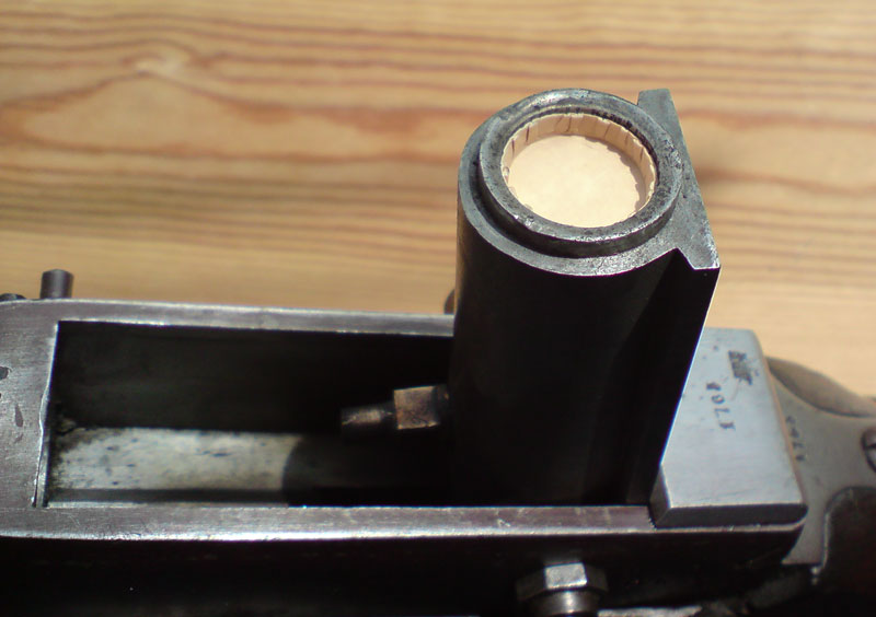

Can you give me the dimensions of that card gas check disc? Diameter and card thickness?
thanks

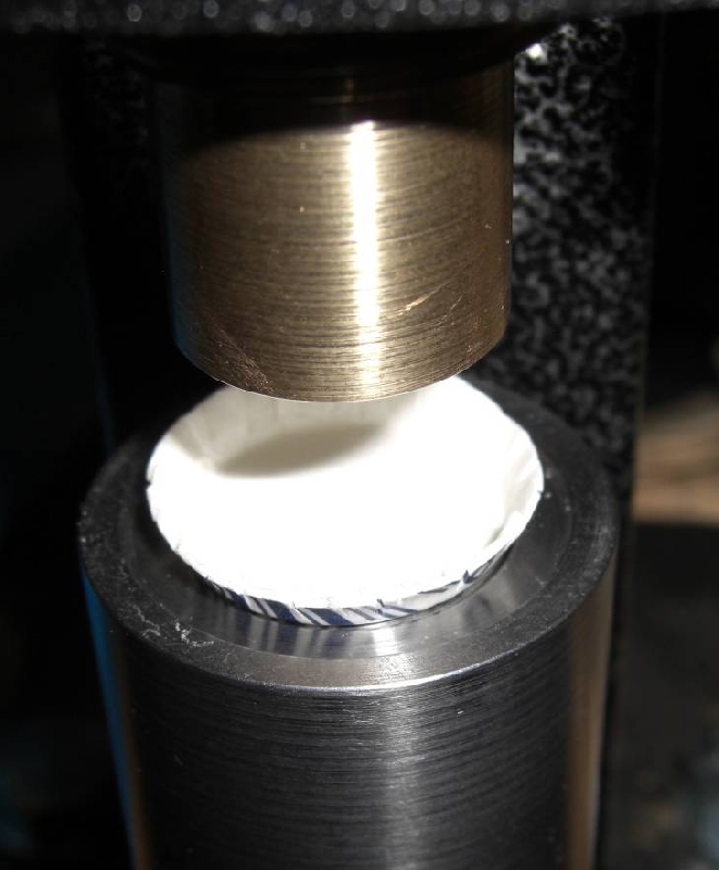

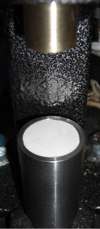

The diameter is 25 mm. I'm not quite sure about the thickness, but they are made from Norwegian milk carton.

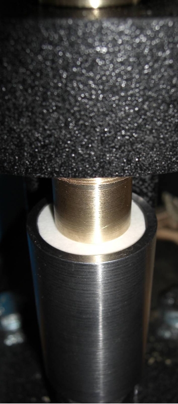

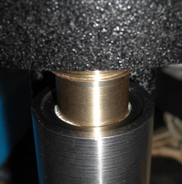

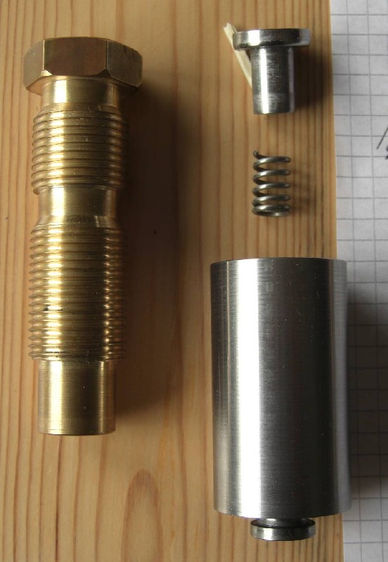

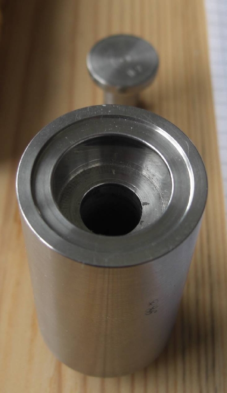

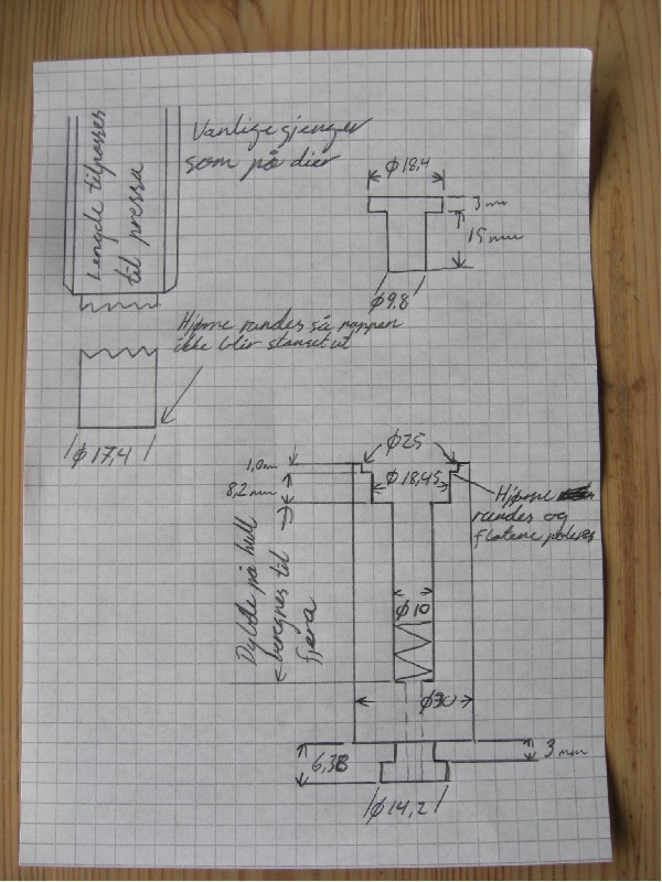

Here are the tool to make gas chek from a pre cut disc, home made in a lathe...
R.
![[image]](images/uploaded/200908052032234a79d037c1b72.jpg)
![[image]](images/uploaded/200908052032584a79d05a8fcb4.jpg)
![[image]](images/uploaded/200908052033324a79d07c98b02.jpg)
![[image]](images/uploaded/200908052034054a79d09ddfd8b.jpg)
![[image]](images/uploaded/200908052034374a79d0bdd0270.jpg)
![[image]](images/uploaded/200908052037064a79d152e60b0.jpg)
![[image]](images/uploaded/200908052037334a79d16d86722.jpg)

Wow, that is really neat! I'll have to sort out something a bit more basic since I don't have a lathe.
Btw Oyvind, I never got anywhere with your friend concerning Danish snider cases
Now looking to see if anyone could turn some from scratch.
